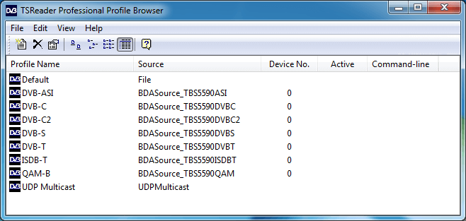

Coupled with TSReader software, TBS5590 V2 is an ideal tool to do real-time analysis, monitoring and recording of MPEG Transport Streams. TBS5590 V2 is supported in TSReader 2.8.53 and later version, which includes source modules for each mode and will automatically reprogram the demodulator when changing modes.
