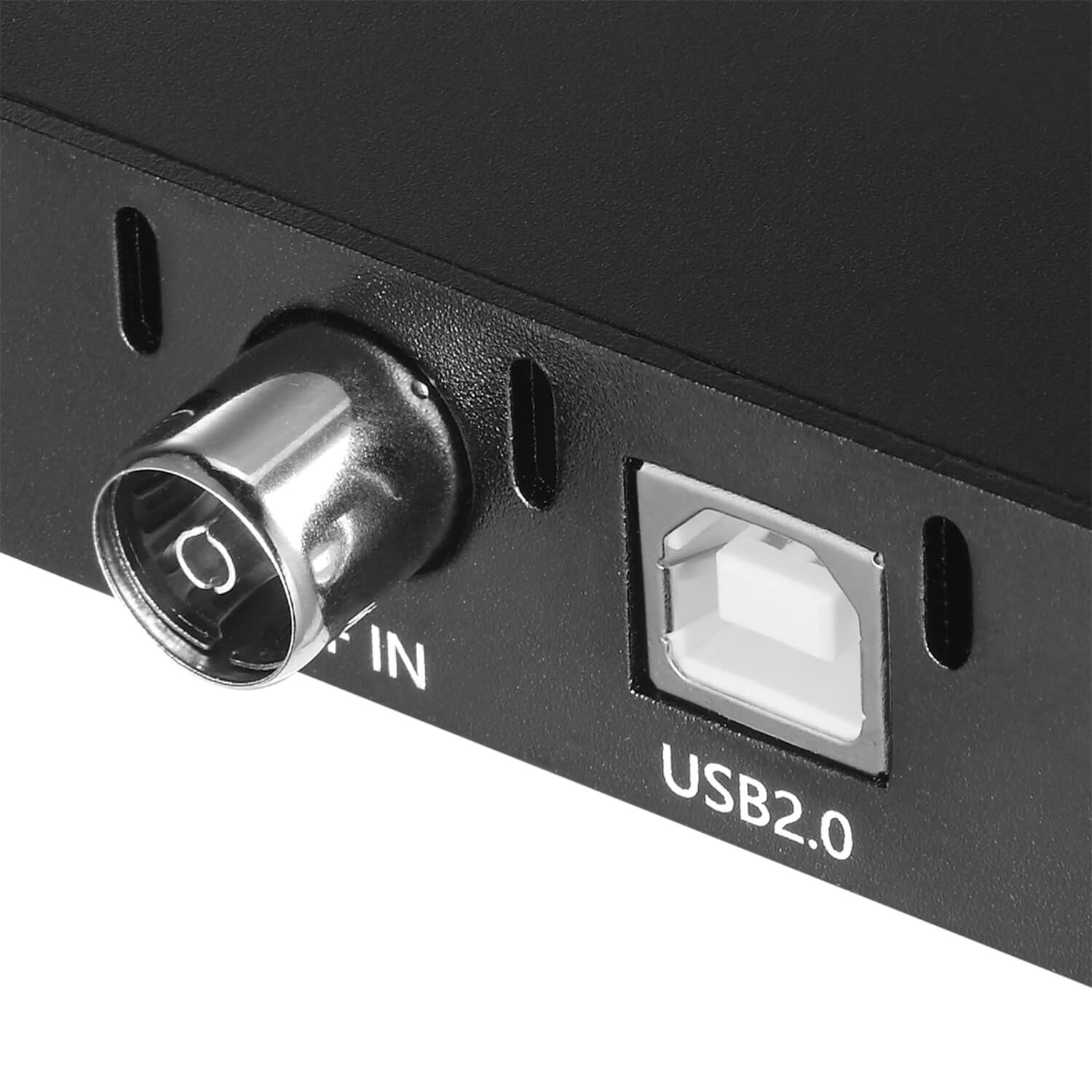

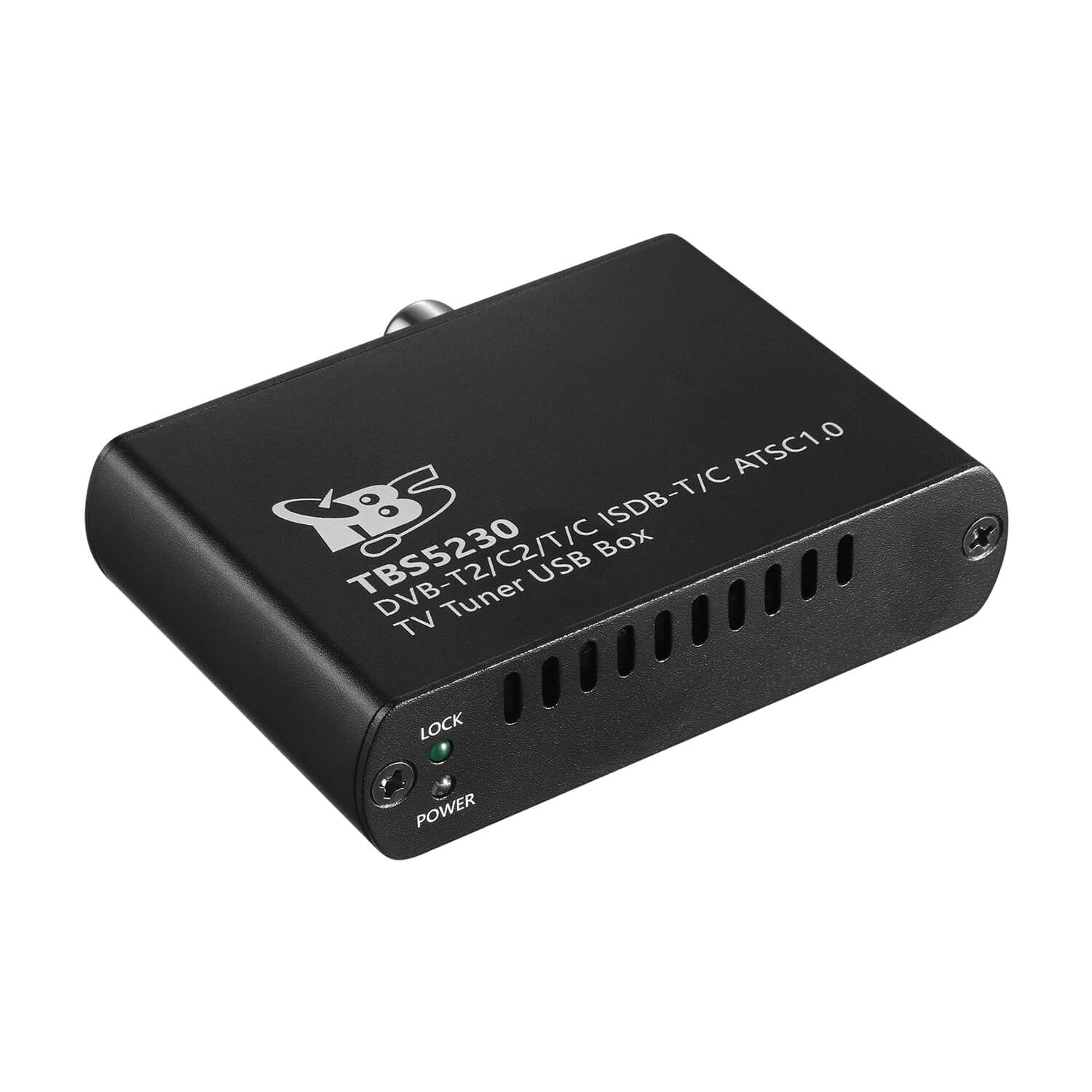

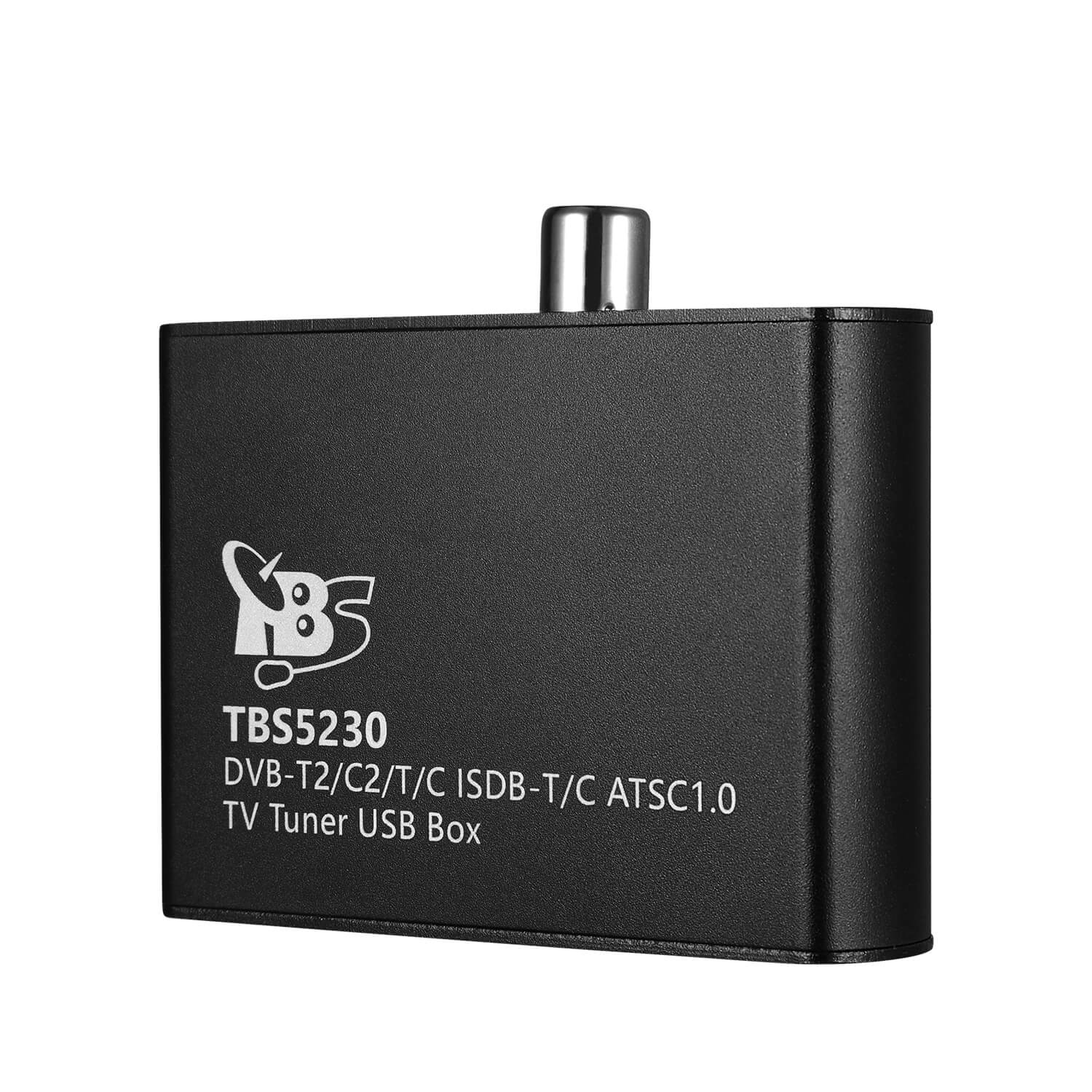

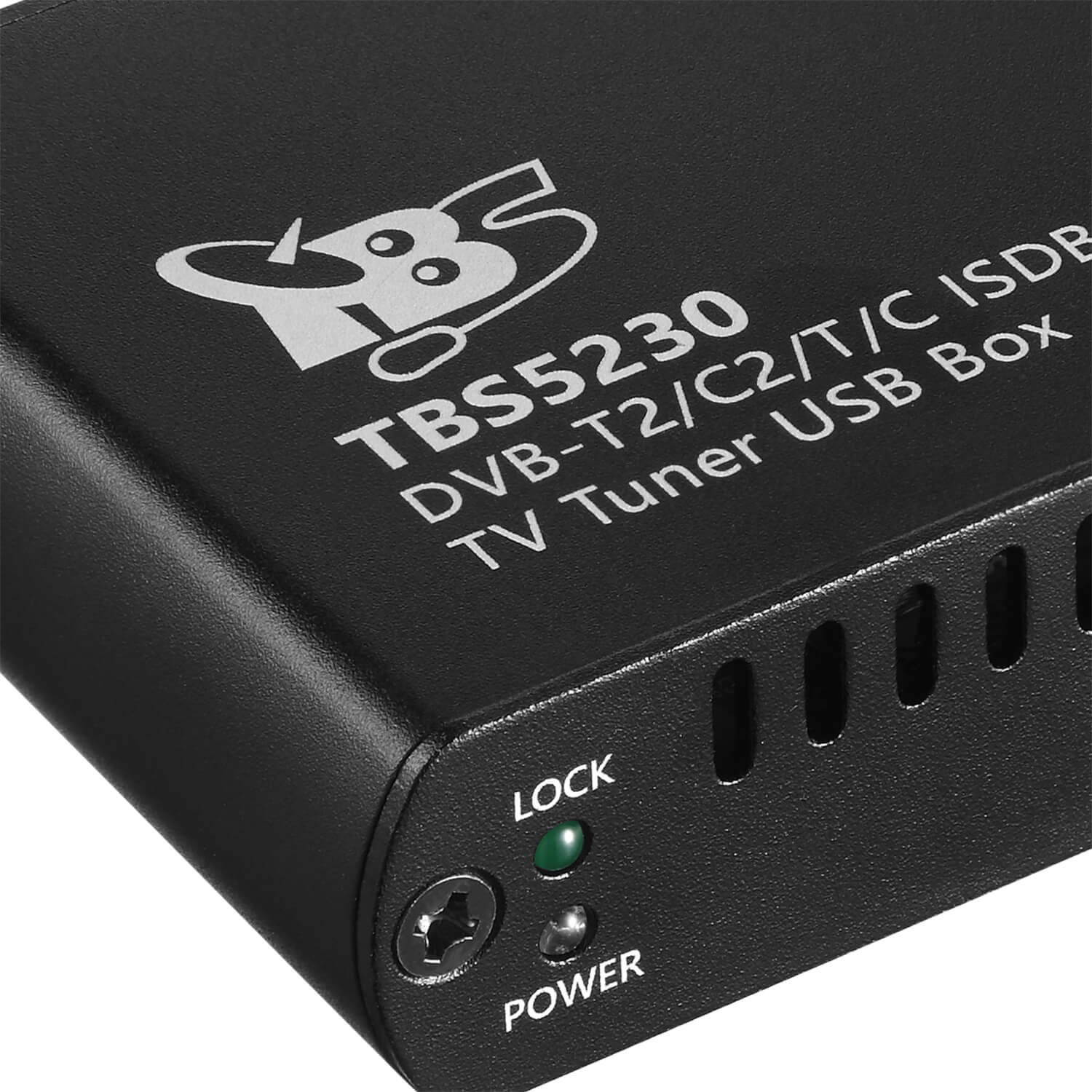

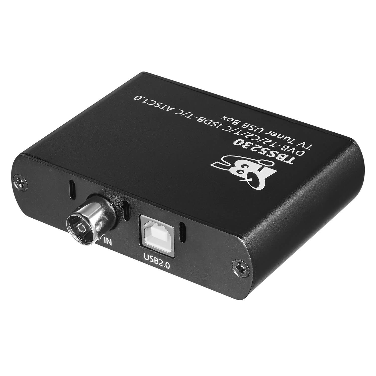

TBS5230 is a external TV tuner card with USB2.0 interface, it is capable of receiving digital TV channels of multiple standards: DVB-T2/C2/T/C(J.83A/B/C)/ISDB-T/C /ATSC1.0. Through the USB interface, you can easily plug the TBS5230 Universal TV Tuner to your desktop or laptop PC, with appropriate signal cable connected and software installed, it's convenient to switch among different standards, and enjoy more TV channels than using just one single TV standard.

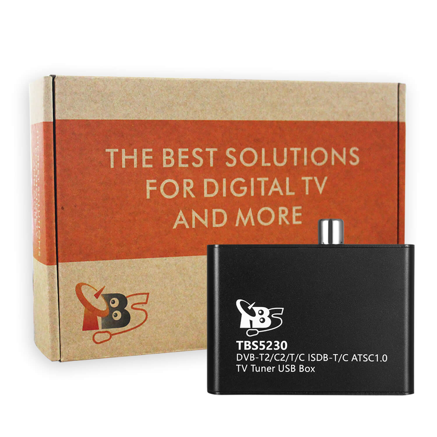

| Gift Box Size | 220 * 130 * 30mm |
| Weight | 350g |
| Package Contents | 1 x TBS5230 |
| 1 x USB cable | |
| 1 x F-IEC | |
