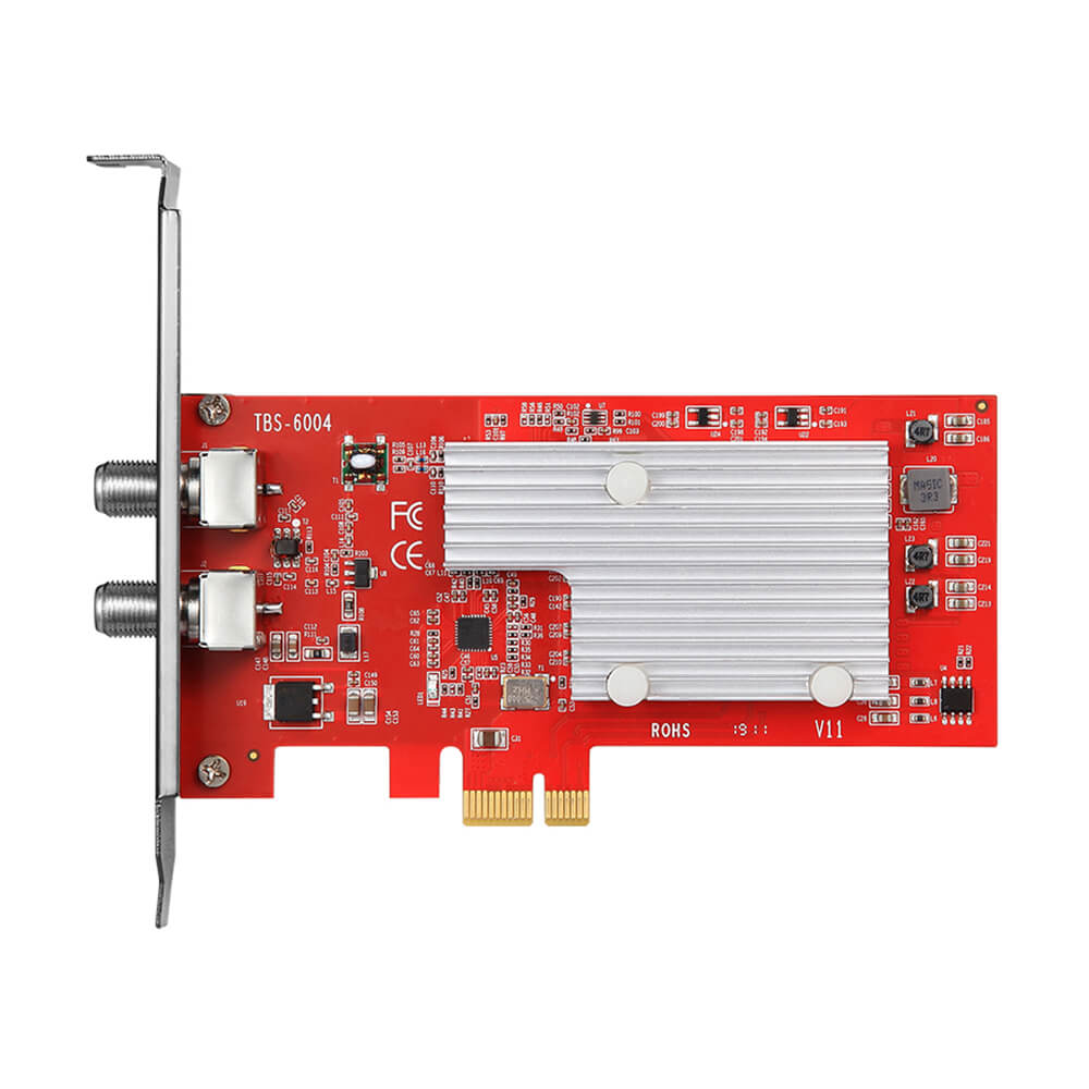

This is a DVB-T modulator card, it works as a DVB-T signal generator and supports 4- frequencies DVB-T transmission.This quad card can convert transport stream to DVB-T signal, for example, you can use a TBS DVB-S2 TV tuner card to receive satellite TV channels and use this modulator card to convert the DVB-S2 TS to DVB-T signal  at the same time, a modern TV or Set-Top-Box with DVB-T tuner integrated can be used to receive the terrestrial signal easily from the modulator card.
This card provides a very cost-effective solution to transfer other digital resources, like DVB-S2/S, DVB-C, ISDB-T, ATSC or even IPTV resources into an existing DVB-T system in hotels, hospitals, or dormitories.
