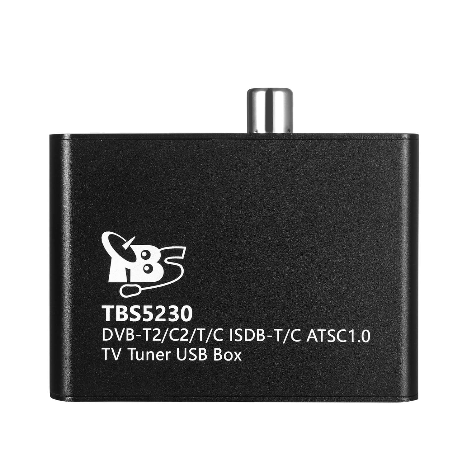

TBS5590 V2 is a DVB multi-standard external TV tuner box with USB2.0 interface. It is capable of receiving digital TV channels of multiple standards: DVB-S2X/S2/S/T2/T/C2/C/ASI/ISDB-T. Through the USB interface, you can easily plug the TBS5590 V2 Universal TV Tuner box to your desktop or laptop PC for watching or recording different standards digital TV channels.
TBS5590 V2 is a DVB multi-standard external TV tuner box with USB2.0 interface. It is capable of receiving digital TV channels of multiple standards: DVB-S2X/S2/S/T2/T/C2/C/ASI/ISDB-T/ATSC1.0
Coupled with TSReader software, TBS5590 V2 is an ideal tool to do real-time analysis, monitoring and recording of MPEG Transport Streams. TBS5590 V2 is supported in TSReader 2.8.53 and later version, which includes source modules for each mode and will automatically reprogram the demodulator when changing modes.
  • DVB-S2X/S2/S/T2/T/C2/C/ASI/ISDB-T, Multi-standard digital TV supported.
  • Universal USB TV tuner Box for watching or recording live TV channels.
  • Supports real-time TV stream analysis & monitoring
  • Supports bitrate measurement
  • Supports elementary stream information analyzing.
